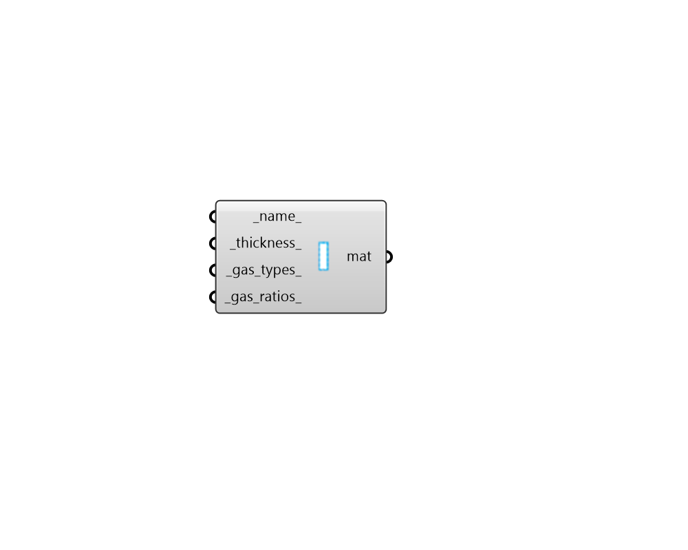

Create a window gas gap material that corresponds to a layer in a window construction. This material can be plugged into the "HB Window Construction" component.
## Inputs
* **name**
  Text to set the name for the material and to be incorporated into a unique material identifier.&#x20;
* **thickness**
  Number for the thickness of the air gap layer in meters. (Default: 0.0125 m).&#x20;
* **gas\_types**
  A list of text describing the types of gas in the gap. Text must be one of the following: 'Air', 'Argon', 'Krypton', 'Xenon'.&#x20;
* **gas\_ratios**
  A list of text describing the volumetric fractions of gas types in the mixture.  This list must align with the gas\_types input list. Default: Equal amout of gases for each type.&#x20;
## Outputs
* **mat**
  A window gas gap material that describes a layer in a window construction and can be assigned to a Honeybee Window construction.&#x20;
