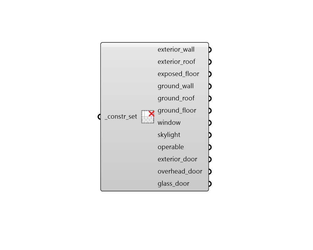

Deconstruct a construction set into its constituient exterior constructions.
## Inputs
* **constr\_set \[Required]**
  A construction set to be deconstructed. This can also be text for a construction set to be looked up in the construction set library.&#x20;
## Outputs
* **exterior\_wall**
  A construction object for the set's exterior walls.&#x20;
* **exterior\_roof**
  A construction object for the set's exterior roofs.&#x20;
* **exposed\_floor**
  A construction object for the set's exposed floors.&#x20;
* **ground\_wall**
  A construction object for the set's underground walls.&#x20;
* **ground\_roof**
  A construction object for the set's underground roofs.&#x20;
* **ground\_floor**
  A construction object for the set's ground-contact floors.&#x20;
* **window**
  A construction object for apertures with an Outdoors boundary condition and a Wall face type for their parent face.&#x20;
* **skylight**
  A construction object for apertures with an Outdoors boundary condition and a RoofCeiling or Floor face type for their parent face.&#x20;
* **operable**
  A construction object for apertures with an Outdoors boundary condition and True is\_operable property.&#x20;
* **exterior\_door**
  A construction object for opaque doors with an Outdoors boundary condition and a Wall face type for their parent face.&#x20;
* **overhead\_door**
  A construction object for opaque doors with an Outdoors boundary condition and a RoofCeiling or Floor face type for their parent face.&#x20;
* **glass\_door**
  A construction object for all glass doors with an Outdoors boundary condition.&#x20;
