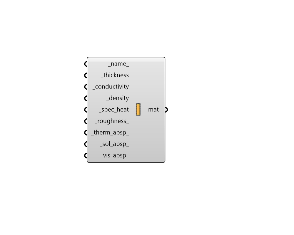

Create a standard opaque material, which can be plugged into the "HB Opaque Construction" component.
## Inputs
* **name**
  Text to set the name for the material and to be incorporated into a unique material identifier.&#x20;
* **thickness \[Required]**
  Number for the thickness of the material layer \[m].&#x20;
* **conductivity \[Required]**
  Number for the thermal conductivity of the material \[W/m-K].&#x20;
* **density \[Required]**
  Number for the density of the material \[kg/m3].&#x20;
* **spec\_heat \[Required]**
  Number for the specific heat of the material \[J/kg-K].&#x20;
* **roughness**
  Text describing the relative roughness of the material. Must be one of the following: 'VeryRough', 'Rough', 'MediumRough', 'MediumSmooth', 'Smooth', 'VerySmooth'. (Default: 'MediumRough').&#x20;
* **therm\_absp**
  A number between 0 and 1 for the fraction of incident long wavelength radiation that is absorbed by the material. (Default: 0.9).&#x20;
* **sol\_absp**
  A number between 0 and 1 for the fraction of incident solar radiation absorbed by the material. (Default: 0.7).&#x20;
* **vis\_absp**
  A number between 0 and 1 for the fraction of incident visible wavelength radiation absorbed by the material. Default value is the same as the *sol\_absp*.&#x20;
## Outputs
* **mat**
  A standard opaque material that can be assigned to a Honeybee Opaque construction.&#x20;
