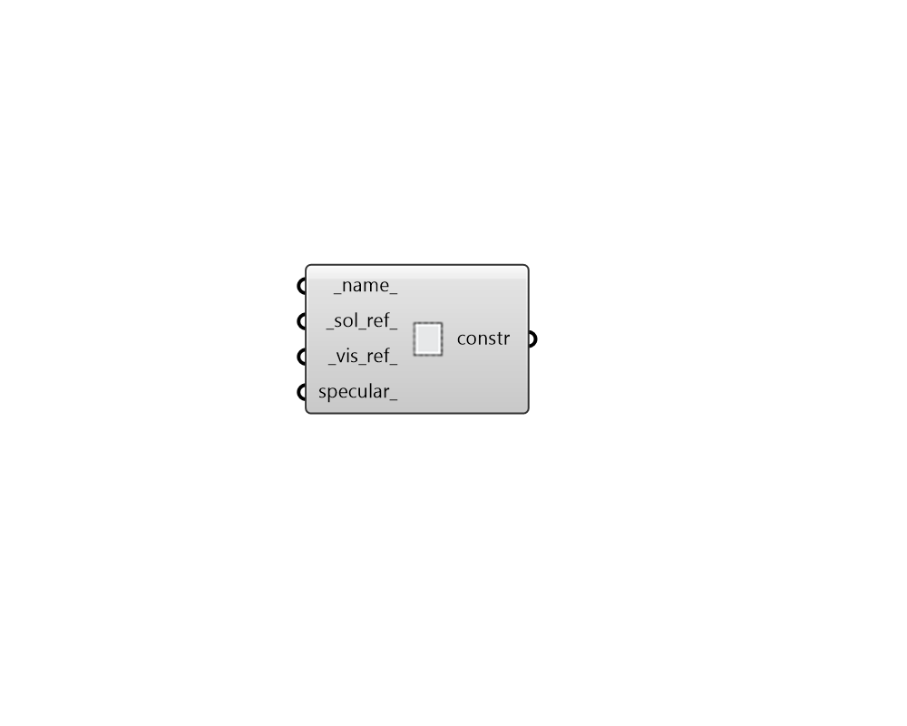

Create an EnergyPlus shade construction. Note that Shade objects in EnergyPlus do not have layers and are only defined by their exterior reflectance.
## Inputs
* **name**
  Text to set the name for the Construction and to be incorporated into a unique Construction identifier.&#x20;
* **sol\_ref**
  A number between 0 and 1 for the solar reflectance of the construction. Default: 0.2.&#x20;
* **vis\_ref**
  A number between 0 and 1 for the visible reflectance of the construction. Default: 0.2.&#x20;
* **specular**
  A boolean to note whether the reflection off the shade should be diffuse (False) or specular (True). Set to True if the construction is representing a glass facade or a mirror material. Default: False.&#x20;
## Outputs
* **constr**
  A shade construction that can be assigned to Honeybee Shades or ConstructionSets.&#x20;
