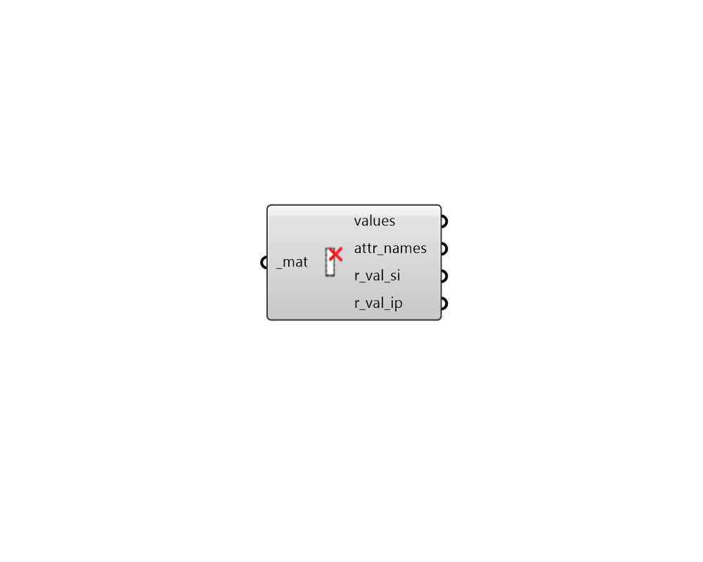

Deconstruct a material into its constituient attributes and values.
## Inputs
* **mat \[Required]**
  A material to be deconstructed. This can also be text for a material to be looked up in the material library.&#x20;
## Outputs
* **values**
  List of values for the attributes that define the material.&#x20;
* **attr\_names**
  List of text that is the same length as the values, which notes the attribute name for each value.&#x20;
* **r\_val\_si**
  R-value of the material in m2-K/W. Note that R-values do NOT include the resistance of air films on either side of the material.&#x20;
* **r\_val\_ip**
  R-value of the material in h-ft2-F/Btu. Note that R-values do NOT include the resistance of air films on either side of the material.&#x20;
